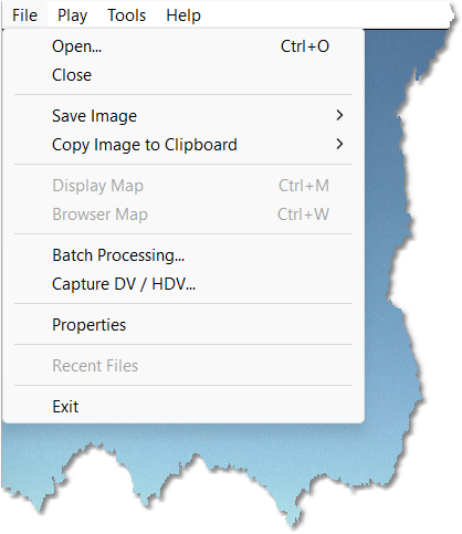

The following items appear under DVMP Pro's File menu.
File menu
File menu
Open

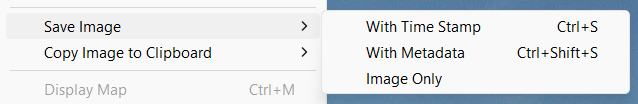

Save Image
pro-menu-save-image
This allows you to save an image file of the video frame that is currently being displayed in the main DVMP Pro player window. You can also choose the image to have burned-in time stamp or burned-in metadata.
You'll probably know that you can use the Burn-in Time Stamp tool to stamp the original recording date and time on a video file, but it takes time to process the whole file. Sometimes you just need a single still-frame image from your video which has the time-stamp written across it - perhaps to include the image in a word processor document or as a photo to be sent as an email attachment. That's where Save Image can be a real time-saver. It works the same as the Burn-in Time Stamp and Burn-in Metadata tools (using the same settings) except that it just stamps/burns-in the current video frame instead of the whole video file.
Just pause playback of your video file, then use the slider or left/right cursor keys to navigate to the exact video frame that you want.
If the image in the player window is the wrong way up, which can sometimes happen if the camera that recorded the video file had stored incorrect orientation information, then you can click Play > Rotate Right (or press the R key) to rotate the image until it displays the correct way up.
Then click File > Save Image and choose one of
•With Time Stamp
•With Metadata
•Image Only
With Time Stamp and With Metadata work like the corresponding Burn-in Time Stamp and Burn-in Metadata tools. If you just want the image without any text written across it then choose Image Only.
A file save dialog pops up that allows you to choose the file name and location of the image file. You can also choose the image file type as JPG, BMP, PNG or TIF. Click OK to save the image.
The quality of the saved JPG image can be set using Tools > Options > General > Save Image JPEG Quality.
You can also use the following shortcut keys:
CTRL+S is the same as Save Image > With Time Stamp
CTRL+SHIFT+S is the same as Save Image > With Metadata

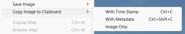

Copy Image to Clipboard
pro-menu-copy-image
This allows you to copy the video frame that is currently being displayed in the main DVMP Pro player window to the clipboard as an image. You can also choose the image to have burned-in timestamp or burned-in metadata.
Copy Image to Clipboard is the same as Save Image except that the image is copied to the Windows clipboard instead of being saved to a file. You can then paste the image directly into a word-processor document or into any other image-aware application.
Like Save Image you can choose to have the image with time stamp, burned-in metadata or just as a plain image. See Save Image for more details.
You can also use the following shortcut keys to copy the image to the clipboard:
CTRL+C is the same as Copy Image to Clipboard > With Time Stamp
CTRL+SHIFT+C is the same as Copy Image to Clipboard > With Metadata

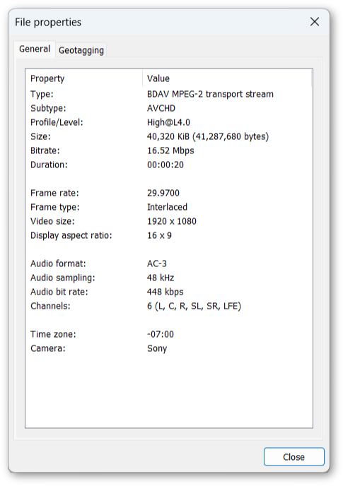

Properties
file-properties2
This displays a file properties box that shows a variety of information about the file that is currently open in DVMP Pro. The information will vary depending on the file type. You can also copy any of the displayed property values to the Windows clipboard by right-clicking a value then clicking Copy.
The property names beginning with "Prem" show the information from the Adobe Premiere file header (if present).

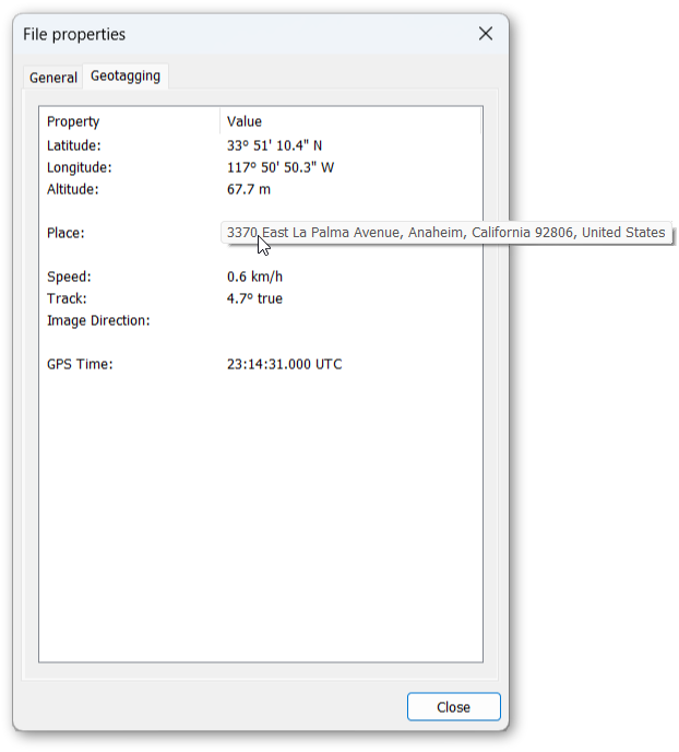

If the file is from an AVCHD, GoPro Black, Insta360, Contour or some other video cameras and smartphones that have a built-in GPS unit, and the unit was switched on when the file was recorded, then there will also be a Geotagging tab present. The Geotagging properties show the geographical location of the camera when it began to record this file. The properties are latitude, longitude, altitude, and the speed and direction of camera movement. Note that the Track is the direction that the camera was moving, not the direction in which the lens was pointed.
If you have an account with Mapbox or Geoapify and have entered your Access Token or API Key into DVMP Pro's settings (as explained in Options - Display Map), then the place name corresponding to the latitude and longitude is also displayed. The place name is fetched from the Mapbox or Geoapify servers, so an internet connection is required. The place name is often truncated in the File Properties window, but you can view the full place name by hovering the cursor over it.
file-properties-geotagging2
You can also copy the full place name (or any other displayed property) to the clipboard by right-clicking it and then clicking Copy.
If there is no Geotagging data present near the start of the file then there will be no Geotagging tab in the file properties box.
Sometimes the camera might not have established a GPS satellite lock when the recording began, and will therefore have been unable to store its geographical location at the start of the clip file. If DVMP Pro can not find any location information at the start of a Geotagging-enabled file, it will search the first 30 seconds (approx) for it. The location information displayed in the Geotagging tab may therefore correspond to any time within the first 30 seconds of the recording. If the Geotagging tab is empty then this indicates that the camera's Geotagging feature was switched on but it was unable to acquire GPS information for the first 30 seconds of the file's duration.
