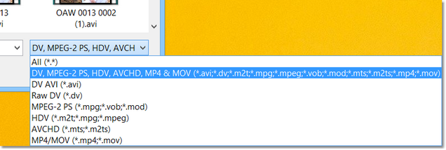

Supported file types in the player's File > Open dialog box
