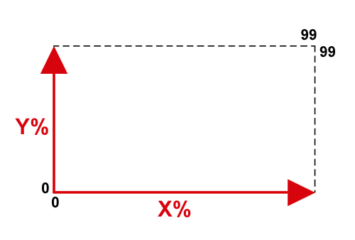

When using one of the burn-in tools, the tool uses the X% and Y% positioning values (see Tools > Options > Burn-in > Positioning) to set the position and direction of each item of burned-in metadata text. The X axis goes from the left to the right of the image, the Y axis goes from the bottom to the top of the image, and the text is written in the direction of the X axis.
X and Y axes for landscape video
In landscape video, the long edges are the top and bottom of the video image, and the short edges are the left and right. But for portrait video, the actual image content is rotated by 90 degrees, so the short edges are the top and bottom of the image, and the long edges are the left and right.

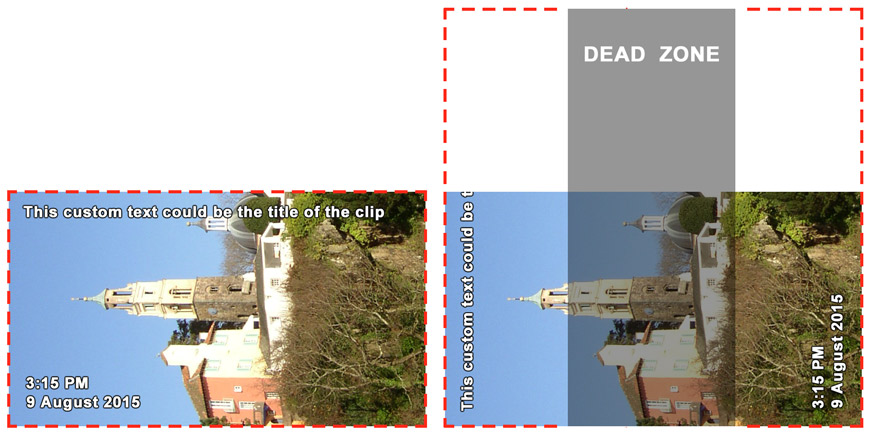

How the Burned-in Text is Rotated
Because you may be burning-in a mixture of portrait and landscape files, it is important that the burned-in text size and positioning are consistent. The text size and positioning is therefore always calculated based on the landscape shape, and then for portrait files it is rotated by 90 degrees. Because the portrait width is less than the landscape width, any text positioned with high values of X%, after the 90 degree rotation may be truncated against the portrait's right edge (being the landscape top edge before rotation).
Burned-in text layer rotated to Portrait 90 degree CCW orientation
Also any text that was positioned with high values of Y%, after the 90 degree rotation would appear about a third of the way down the portrait image. This isn't ideal, so DVMP Pro applies an adjustment to the text positioning for portrait video. For metadata text items whose Y% value is set to 50% or greater, their position is shifted so that they are justified to the portrait top edge. This means that there is a 'Dead Zone' across the middle of the portrait where no text can appear, but that's OK as it's very unlikely that you would want text written across the center of the image.
